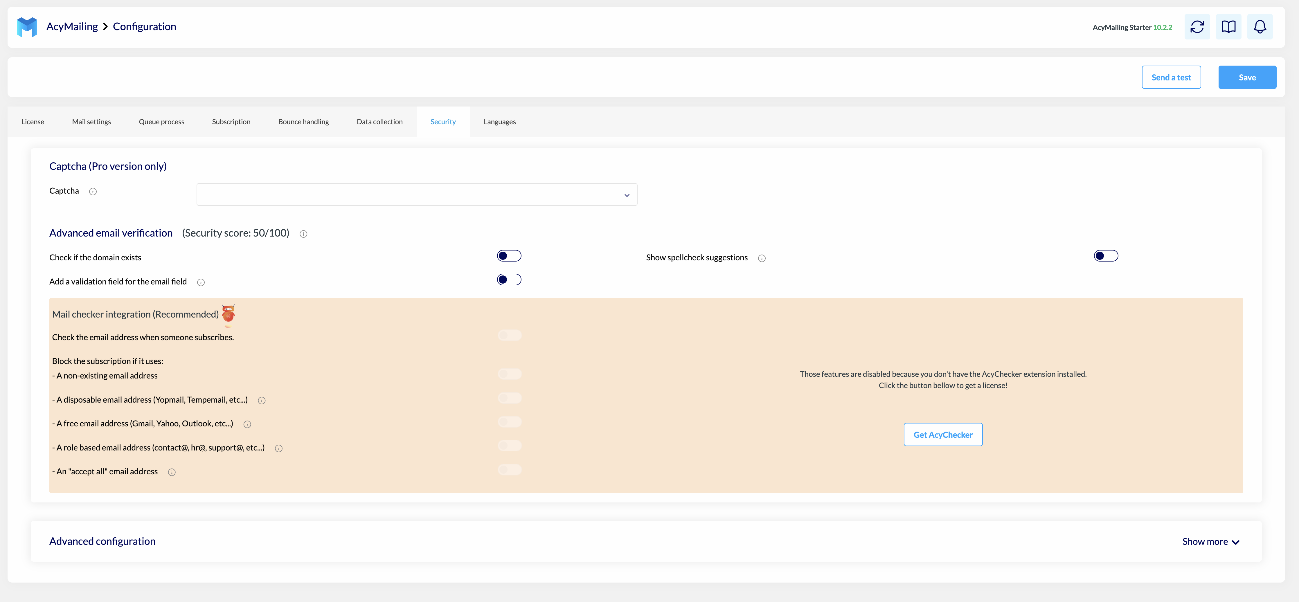

So I'm following the documentation about creating a web hook on Brevo for bounce and unsubscribe but have run into an issue. I see nothing that says Security Key under the Security tab in AcyMailing.
If you go to advanced configuration there is something that says Cron Security key, is that it? And does it need to be turned on?

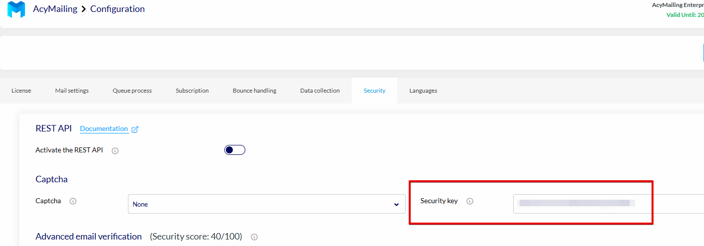

No, the cron security key can be used in case you setup your own task on a cron server. The security key you are looking for is at the top of the page.
I'm using the starter version and there is nothing there next to Captcha. So I would assume I need to upgrade to a paid version for this then?

Wow, we were not aware this was already implemented. You need to upgrade your Acymailing to the Essential or Enterprise version to be able to use the security key.
